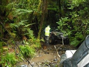

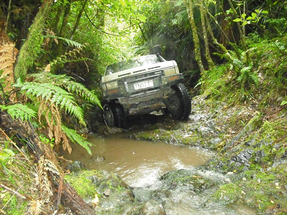

I popped an outer bell yesterday trying to get up a high traction ledge in a section called Diff Dinger or something similar. Had wheels turned quite a bit in a shitty spot.
Rear diff was hung up completely so driver side front was trying to pull the whole vehicle off the rock and up. In retrospect I should have taken a bit more time to negotiate the section. Also it was at the limits for a vehicle on 33" tires, the other guys were running 35-37s.
Heres the moment of it popped. The rock in front of the driver wheel is what finished it off as I tried to bump it over.
The rear diff clearance is really pissing me off.
I just continued in 3wd and drove it home. Later I'll do a write up on how to change them. If you have air tools it takes about 10 mins to swap out a CV. And with IFS the carnage is all isolated so theres no domino carnage effect.
