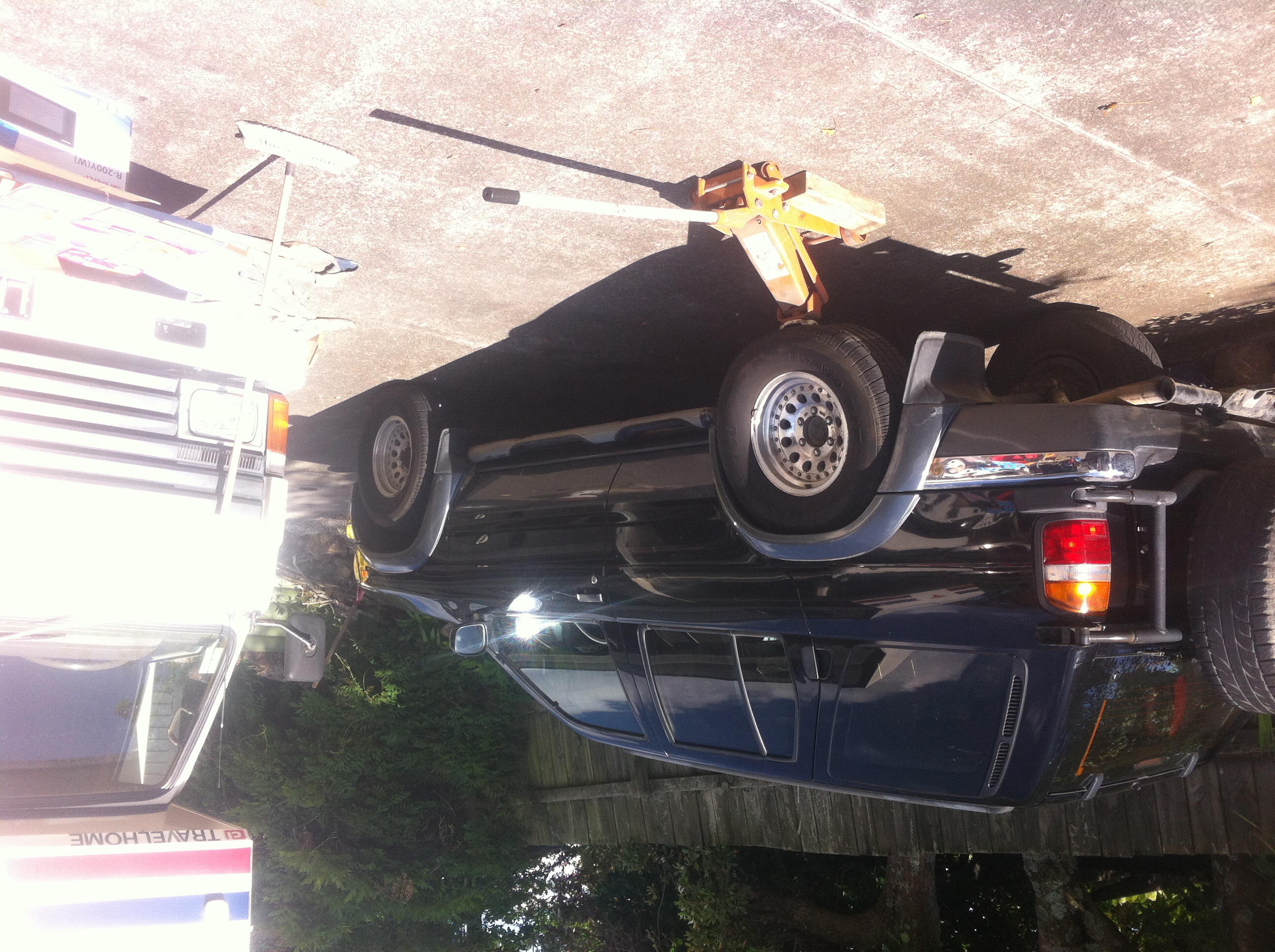

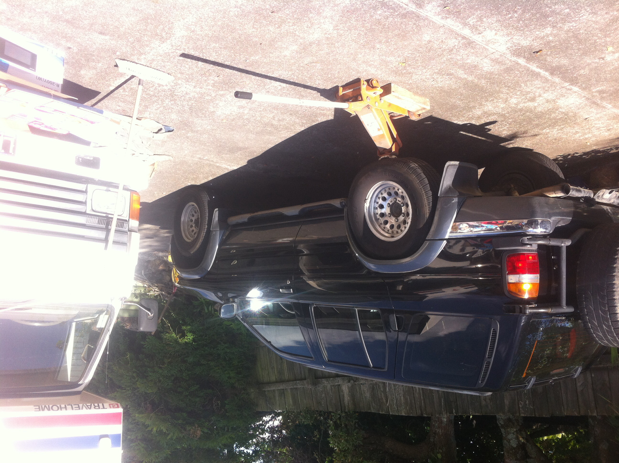

This is my truck testing the flex on standard suspension. Sorry the pics upside down.
