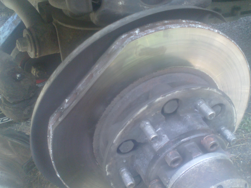

Yes, well, it would have been a morning's work, except that I apparently forgot to torque one of my wheels back on. - Watching your front left wheel overtake you and then head for the hills, is quite the experience!
Pah!, who said brake rotors needed to be round anyway! :oops: :oops: :lol:
1989 LWB 5-Seat TD42
catalystracing
Posts: 820
Location: within the matrix
Re: Manual hub servicing
Post by catalystracing »
MihiT wrote:Yes, well, it would have been a morning's work, except that I apparently forgot to torque one of my wheels back on. - Watching your front left wheel overtake you and then head for the hills, is quite the experience!
Helps clear the mud from the calipers.... :roll:
