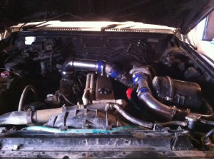

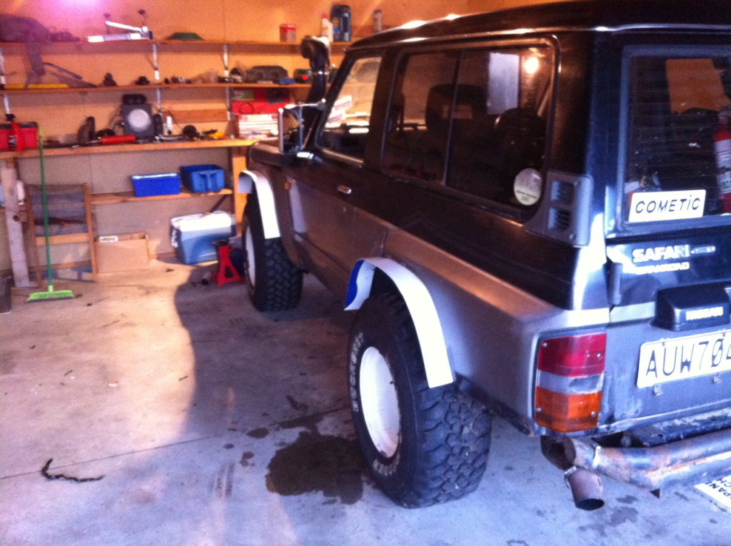

This is my ongoing project for the last year. Lightly modded nothing insane but very useable. Has 2 inch coils and 1 inch body lift. 33" Buckshots. Front and rear bar work. Snorkel. Turbo conversion. Truck goes well, looking at a winch in future and some comms gear.

is the garden hose connected to air intake prior to turbo?
Re: Dundabergs Y60 Shorty!
Yeah pre turbo, where the red tape is. Rocker cover breather. Will be getting some silicon hose on there when i get it back from getting its rebuild. Oh yeah trucks in at the local Nissan workshop getting new big ends, rings and pre combustion chambers (a few were cracked) and a head skim etc. Hoping to have it back next week hopfully.

Busy 15 minutes, found a few photos, thought I might post them up.

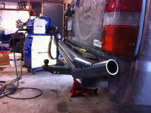

get tube and steel end caps for your rear pipe work looks neater
coxsy wrote:get tube and steel end caps for your rear pipe work looks neater
Yep have done lol, just cant tell in the photos

So got a new set of 15x8s yesterday to replace the 15x10s. this weekends mission, cutting and welding the rear caps. Then 4" snorkel!
