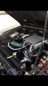

91 manual 2l-Te Prado . I swapped in a 1kz with a mechanical pump,bigger turbo, and top mount . Here's the problems.... The motor I brought was a auto and I'm running the auto loom into my manual 2lte computer. I need to bypass the inhibitor switch, but how..? I've had it running but only by running a wire from the starter to the battery. It goes really good but the factory turbo dash light flickers at 15psi and sort of cuts the power till I back of the gas..? I hate electrical things but hanging to get it sorted. Any help is greatly appreciated.

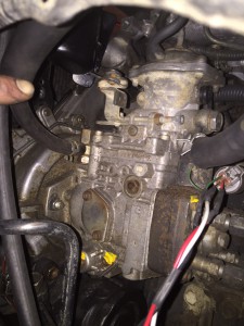

Take a close up photo of the injector pump as I cant see the throttle cable to the manual pump....

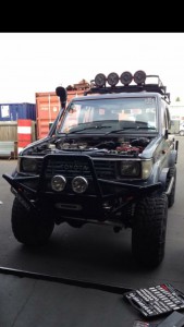

Hi thanks for your reply. I solely brought this motor as it had custom build mechanical pump and really went well. I built all the brackets and got a longer excelorator cable. I'm 30 years old and this is my hunting bus . I'm a fabricator and do all the work myself ,not a young idiot talking it up. but hate the wiring side. I'm diff still running my 2lte computer as thought I might need it for lights, windows, heater etc. ??? I brought a actual inhibitor switch tonight and have tried wiring to the kz engine loom hoping I could manual turn the switch around to nuetral.. But no luck. I'm looking for that plug you were talking about now , cheers Andrew
Re: Lj78 Prado.
The day I pulled the old 2.4 out. Dec 19 2014, I lost interest this year as I'm building a jet boat. But now am eager to get my truck wiring sorted.
