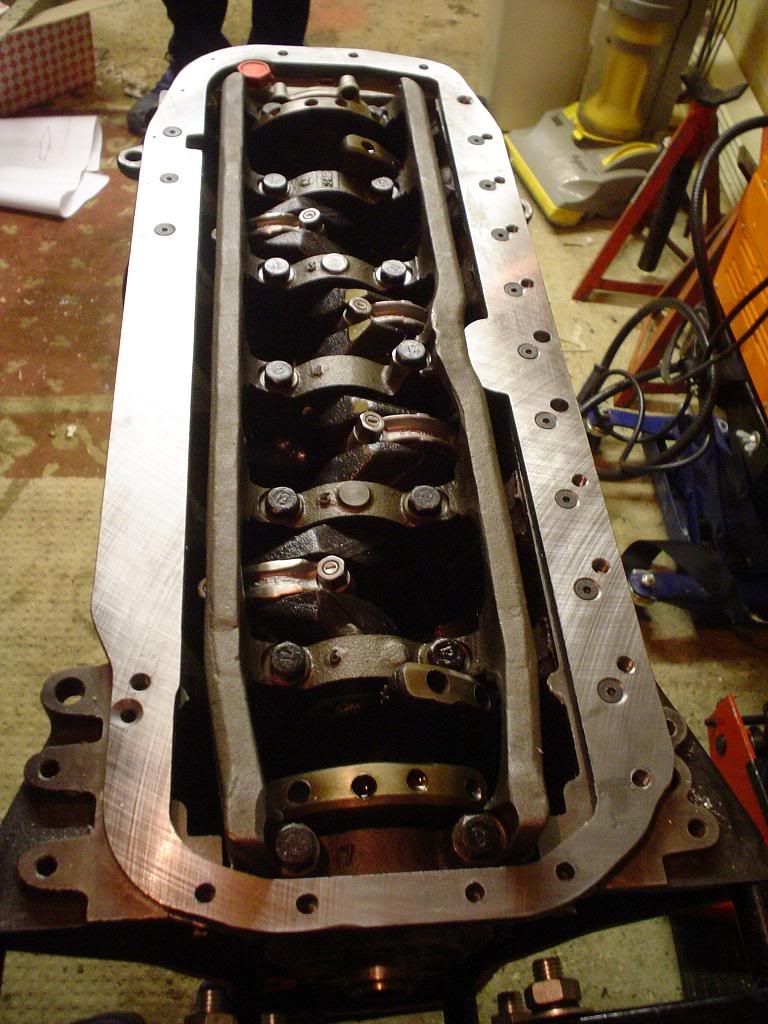

A 4wd RB engine has a different sump bolt pattern and oil pick up location to a RWD engine and the sumps don't interchange. Easiest option is to chop the front diff off the 4wd sump and plate the hole.
- Crash bandicoot
- Posts: 2924
- Location: Towing a hilux
Re: RB25DET Auto into Y60 TD42 Safari Help Required
easy enough to get 10mm adapter plate and flush hex machine screws. quite common conversion
