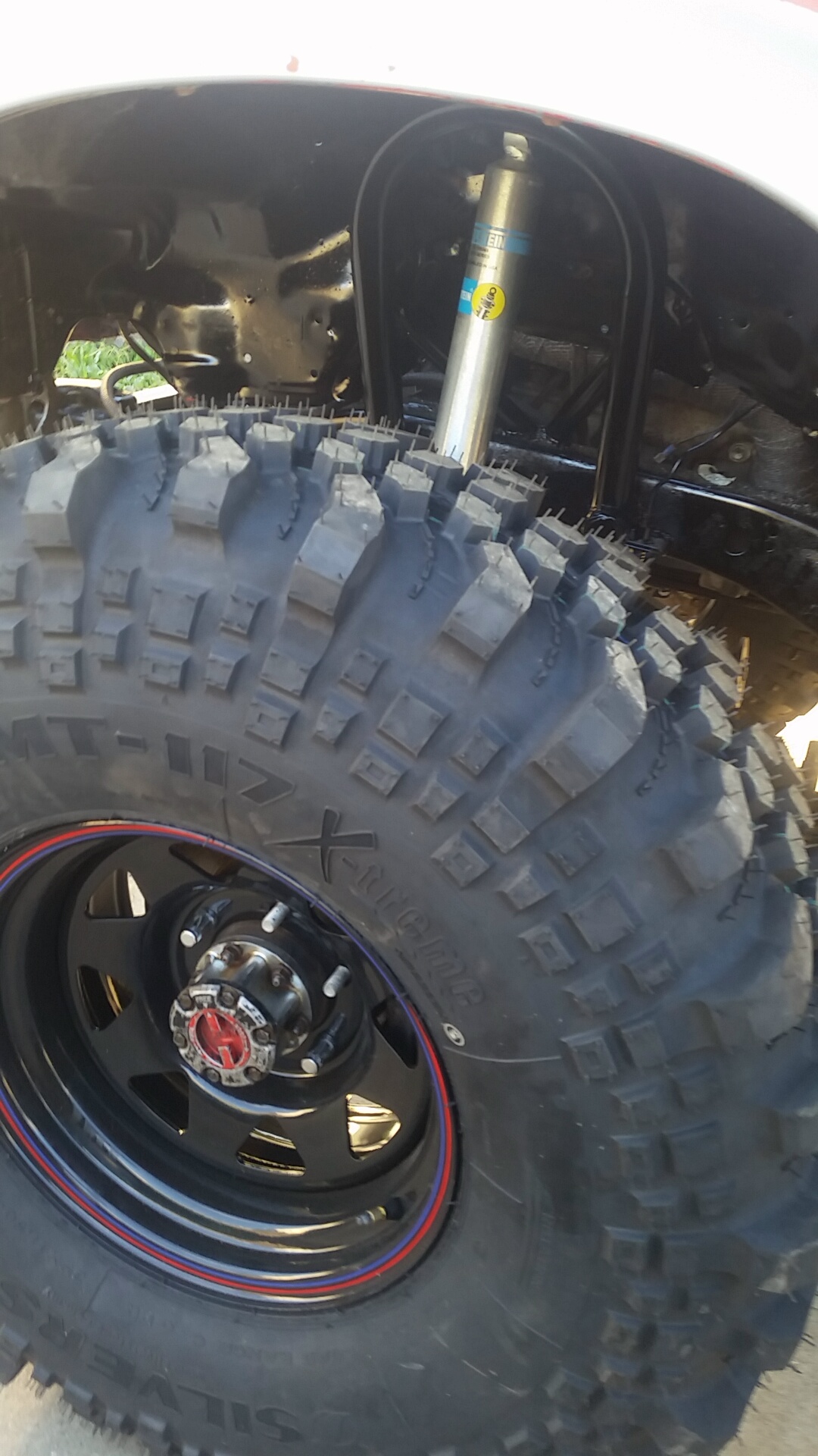

Rolled the surf i built and now got a new project and started frm scratch apart from motor and wheels, done cross over steer, rears up front, front and rear u bolt flip, braided extended brake lines got 12inch bilstein shocks for front and rear and done ifs hub swap and bigger calipers lsd diff in front and welded diff in back so far and going to try get done for rallywoods on queens bday weekend

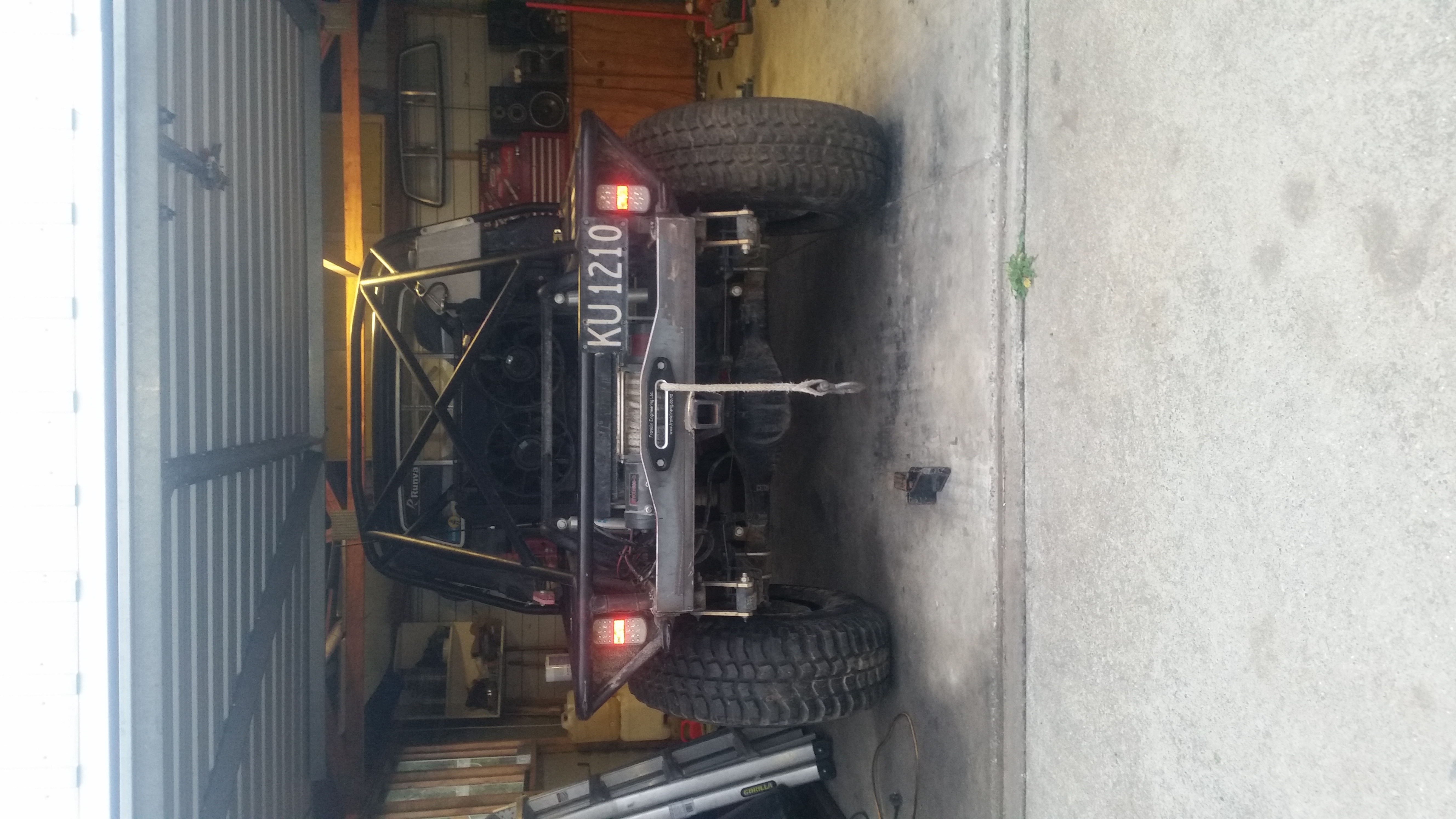

you need to lift your shed, your door isn't big enough

Haha i know reece bigger shed with a hoist is on the list 2 be done in the next year or 2

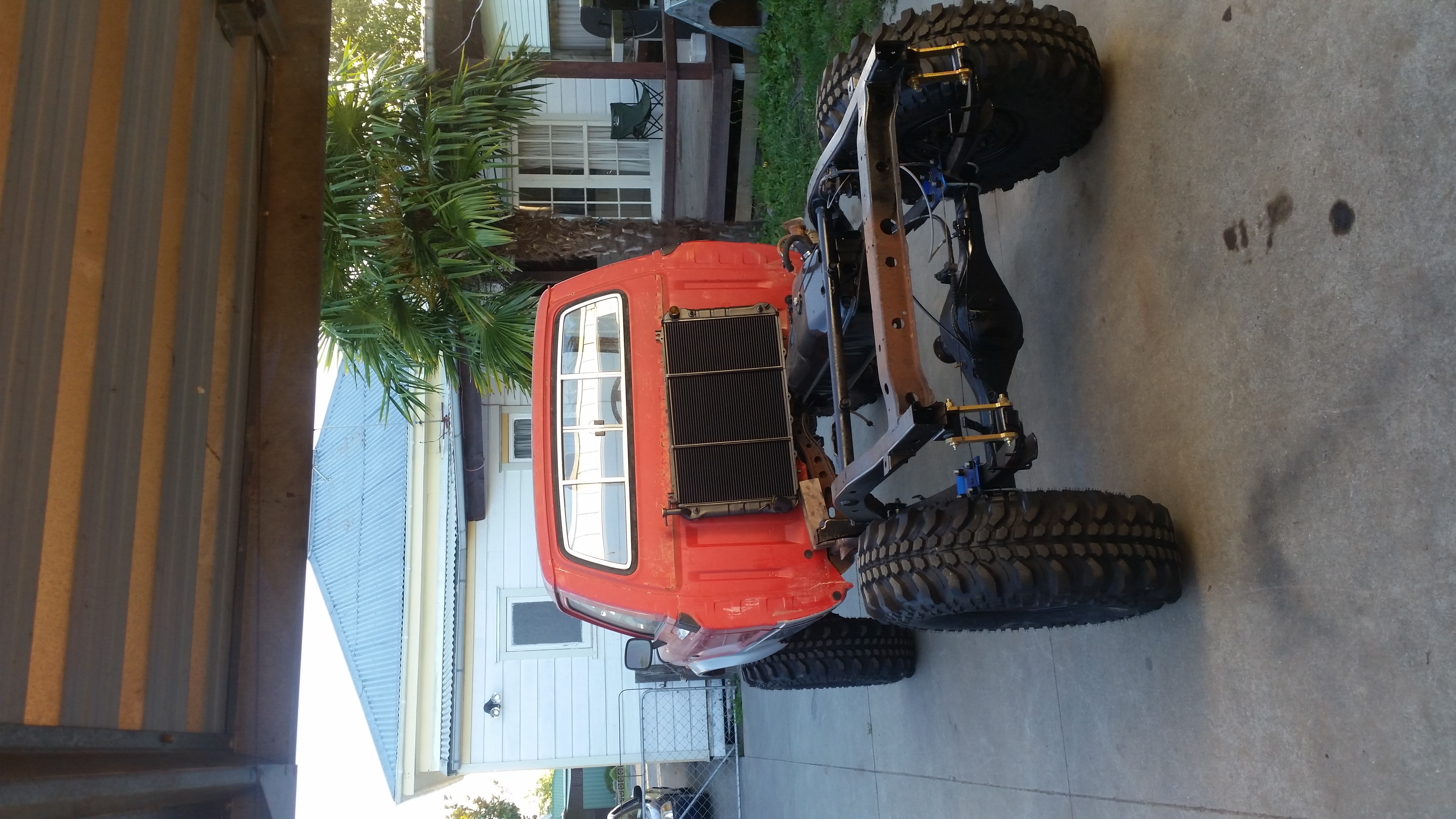

Busy weekend moving trucks around and doing some work to get motor ready to go in got manifolds heat wraped and draining trans to mount transfer box bought a copper safari radiator to mount on back and have a runva competition winch on its way

Had good condition bumper on it but took off and going to build winch bar with winch in where radiator used to be bought a new runva competition winch

Shock towers all mounted jst got to paint thm then put motor in

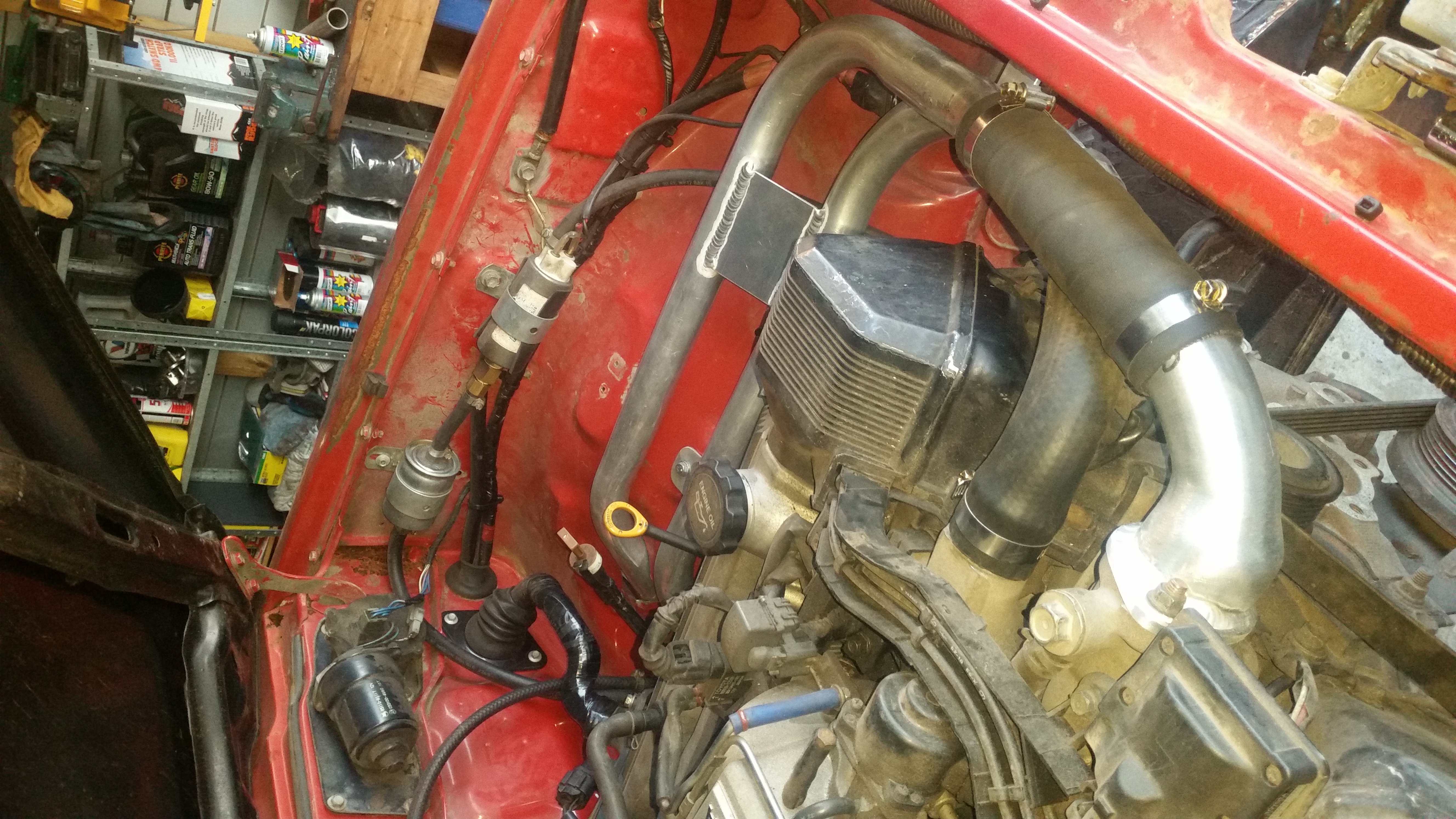

Motor in and shocks in and motor almost finished being wired up

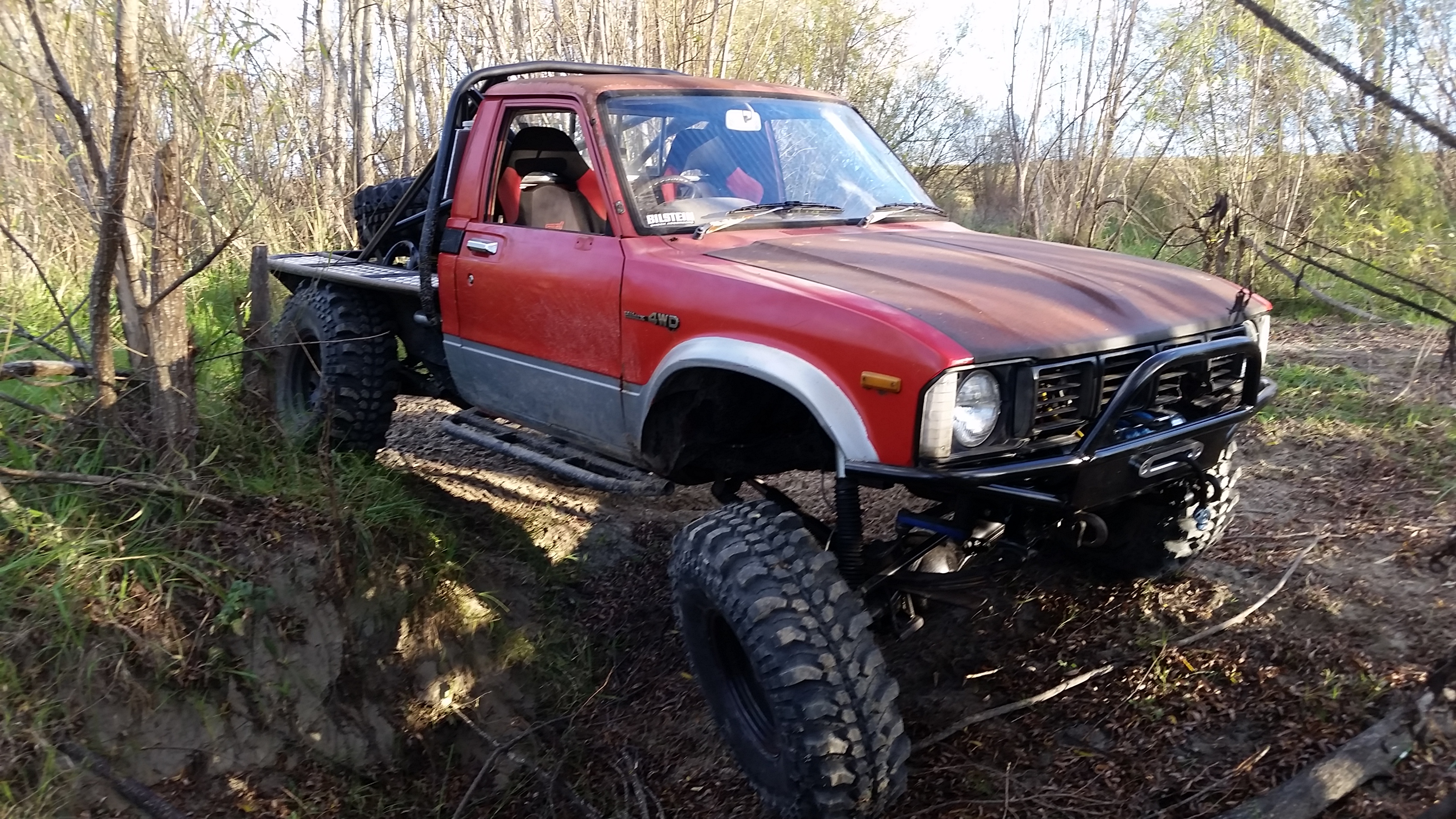

Truck done for now ready for rallywoods just need to lower front bumpstops a bit more

Rear winch done and few other bits and pieces and few more sets of wheels and tires and exo cage started almost ready for rallywoods agen

Exo cage finished just few little bits left before its back out getting thrashed agen
