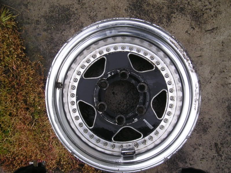

Have a bit of curbing but nothing too bad, look to be 2 piece.
Universal measurement of dish says it all, are a bit dirty but would polish up choice with some autosol Wanting $600 will ship them no prob if the buyer pays

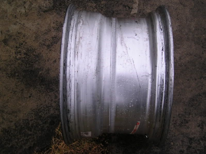

Are you sure about offset Looking at cellphone plus clearance dish is about 120mm deep which would be about zero offset on 91/2 rim. Can you confirm measurement from mounting flange to inside of rim, also pcd is 139.7 mm, thanks as interested. Where r u?
Cell phone probably a bit longer than mine, was thinking more like a neg offset, more likely 32neg if 32 is number on rim. As a 91/2 " rim with +38 would have about 150mm backspace which would not fit safari, catch on tie rod on inside of rim, just needed to check on that.
Have done some measurements Overall width -268mm Mounting face to inside lip -90mm 268mm/2=134mm centerline of rim 90mm-134mm=-44mm Makes them a negative 44 offset
