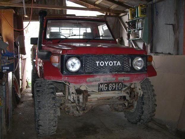

I had the centres of my rims flipped and had a 4"lift. doing that meant I could run 35x12.5 simexs no problem...

Not overly keen on a body lift as want to keep the COG lowish, had a few tippy moments with 3" lift/skinny feet on before going to the bigger offset and tyres. Plus the front bar is a custom setup with no allowance for body lift. I'm looking at 35/11.5 silverstones with -40 offset rims for the harder stuff and keep the 33/12.5 Bighorns for river runs etc. Might just be a toss up between 4" lift springs and guard chop.
wjw wrote:I had the centres of my rims flipped and had a 4"lift. doing that meant I could run 35x12.5 simexs no problem...
Would the centre flip be the equivalent of -40 offset or more?

it all depends on the individual rim and where they re-weld the centre back in, the 8" beadlocked set I had done came out with about -75 offset and 40mm backspace
wjw
Posts: 3420
Re: What Rim offset are you running Early Prado
Post by wjw »
They were:
4 x 15 x 8 Steel rims
-44 Offset
70mm Backspacing
Who knew Prados could fly?
