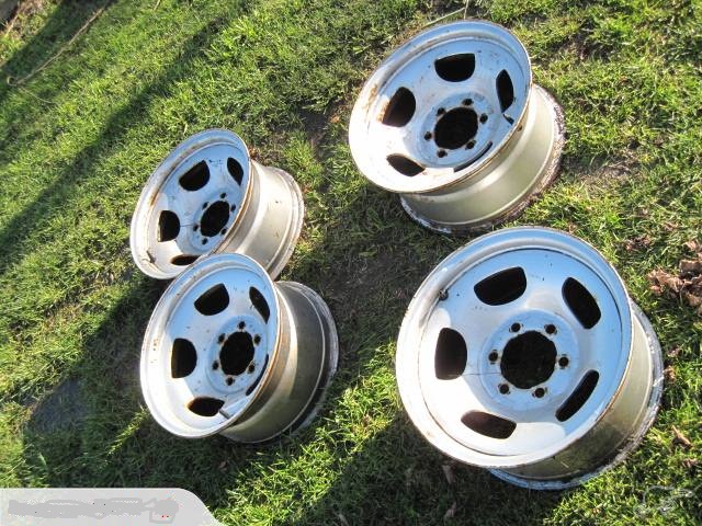

Re: What Rim offset are you running Early Prado
They were:
4 x 15 x 8 Steel rims
-44 Offset
70mm Backspacing
-44 Offset
70mm Backspacing

Who makes these 15x8's with -44?
