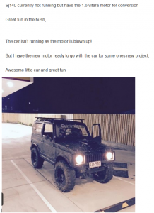

Hey Members,
I am seeking advice on the possibility of putting a 1992 1.6L Vitara engine into a 1988 SJ410.
Seller is selling the SJ410 with a blown 1.0L engine and a running 1992 1.6L Vitara engine with 220,000km for $1500.
