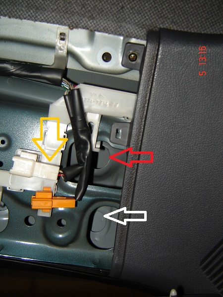

Re: Is it easy to fit a spoiler to a surf?
are these the holes it screws into?

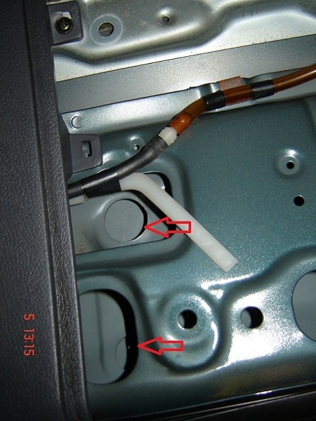

are these the holes on the othe4r side and are they the plugs for the light?
Yeap, that looks like them, you'll just have to drill them out once you get the spoiler. Everything else should come with the spoiler.
