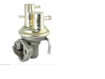

Second: The fuel pump - I did a bit of reading which all said the fuel pump is worn out, but has anyone had problems with a leaky fuel pump that was caused by blow-by. As in - if I put a new pump in is it likely to leak as well until the blow-by is fixed?

Just replace the fuel pump, the rubber seals inside deteriorate over time and can potentially let petrol enter the oil which is obviously very bad. I would change the fuel pump and do an oil change.

just buy a electric pump (make sure its a low pressure one for carbs) off trademe for $80 and blank off the mechanical fuel pump hole.
Re: Oil…oil…everywhere - Story of a Bleeding Samurai
What a good idea!! Sweet thanks for that. Do you need to run a return line with a restriction so the thing keeps pumping or do they just supply what is required and slow down/stall?
not normally ,depends on your setup is the fuel return from your carb or from the pump?
standard fuel pump has the return line from the mechanical pump.
2 problems with electric pumps ,
1 . you know have an electrical device under the truck to go wrong.
2 . they can cause flooding in the carb if the float valve is not working quite right . ( normal for older Zuk carbs)
you can buy suzuki genuine rebuild kits for the mechanical pumps for about $80
easy job to do
easy job to do

well i am not sure what brand pump you are buying but i would change brand, one question why would anyone mount a fuel pump under their truck ???? it doesnt hurt the pump to suck fuel because once it has pressure they hold it and as for over pressurising the float, most pumps are adjustable so you can match factory pressure!!!!
this would be a good one to try http://www.trademe.co.nz/motors/car-par ... 686388.htm ,put a fuel pressure gauge on your pump and see what pressure you are running and get one to match!
Mount it on you fire wall not under your truck! and make sure you do your wiring properly and you shouldn't have any problems.
Your call but i think its worth a shot!
Yes but then you have the added hassle of making something up to cover the hole.
Well i can't speak for everyone but making a plate off the gasket isn't that hard.
And if he gets stuck he is more than welcome to send me a gasket and i will make it for free of charge.

http://suzistore.com.au/onlinestore/four-wheel-drives/lj-4x4/lj-4x4-lj80/fuel1956900166/PUMP-KIT-FUEL-2424-detail.html
this I the kit I used . suits the muikini factory pump.
you should just be able to undo the bolts around the perimeter and the pump comes apart .

Bugger yeah my one looks like this..I guess the ones with the ring of bolts was from a time before we just threw things away?
