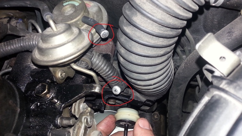

I know there are a million threads on this but I just want to make sure what I've done is correct.
Following the spread sheet below I have blocked off the hose that had the little UFO thingy on it.

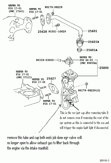

That way will stop the actuator operating however if the valve doesn't seal properly you will still be pumping gasses into the intake.
Most people just slip in a solid plate where the gasket is... either end of the pipe will do...

Cheers mate. So I should follow it to where ever it goes (as the end near my photo would be a c*** of a place to remove) and put a blank in there.

I think you will find it is the easier end. As the other is at the back of the manifold and there ain't much room. Plus the nuts n studs could be seized due the heat from the manifold.
